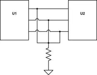

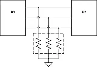

One common use of a resistor network is to pull multiple lines up or down, e.g. on a data bus:
Replacing the resistor network with a single resistor would short all of the lines in the bus together, making it not work at all:
