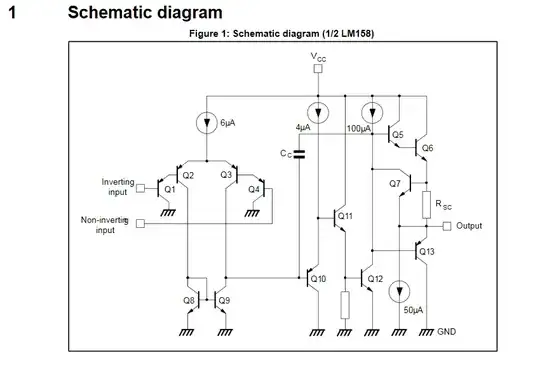

    re: crossover distortion: If the OpAmp can slew 9V/uS won't it be able to traverse the deadzone in a few hundred nanoseconds? Or is that not fast enough? – Frosty Sep 19 '17 at 19:02
    How fast the opamp is is **irrelevant**, there will still be crossover distortion. It will be **less** compared to using a slower opamp but the distortion will still be there. Anyway, that slew-rate of the opamp means little if it cannot change the voltage at the output (where the large transistors are) as quickly. Also those large transistors might slow things down. – Bimpelrekkie Sep 19 '17 at 19:29
  • *Or is that not fast enough?* Fast enough for what ? There is no "good / bad" in electronics. If you build an audio amp with this it might be good enough for elderly people as these cannot hear high frequencies due to distortions. But the same audio amp will be thrown out of the window by someone with excellent hearing who values distortion free sound. – Bimpelrekkie Sep 19 '17 at 19:33
Whether the class-B stage you propose is a good choice depends entirely on the application.
When the output current changes sign, the opamp will have to slew to turn on the other transistor, as you mention. So it will generate a large amount of crossover distortion.
For driving a DC voltage into a load, it will be absolutely fine.
For audio, it would sound like crap: since audio signals spends most of their time near zero amplitude, any discontinuity near zero is a deal breaker. If the signal is small enough, but still keeps changing sign, because it's AC, this simple design can end up with more distortion than signal...
For driving AC signals into a load, that'd depend on the frequency and the allowable amount of distortion.

It simulates fine, but I am pretty sure it will not work as drawn in practice. For one thing, any actual opamp cannot swing instantaneously through the 1.4V crossover region without some form of distortion. I'm sure there are other things as well.
Indeed it can't. The rate at which the opamp output can charge is the slew rate. For example the LM358 has a slew rate of about 0.5V/us, so it would take about 3 microseconds to swing through the crossover region.
Many opamps internally suffer from crossover distortion as well, which should be clear when you look at the equivalent schematic and see a class B amplifier for the output
