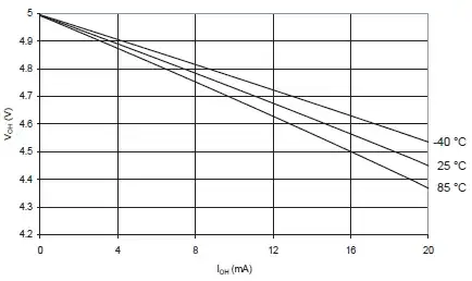

The following graph from the ATmega's datasheet shows what will happen if you drive the LED without current limiting resistor:
Without load the output voltage is 5V as expected. But the higher the current drawn the lower that output voltage will be, it will drop about 100mV for every extra 4mA load. That's an internal resistance of 25\$\Omega\$. Then
\$ I = \dfrac{5V - 2V}{25\Omega} = 120mA \$
The graph doesn't go that far, the resistance will rise with temperature, but the current will remain very high. Remember that the datasheet gave 40mA as Absolute Maximum Rating. You have three times that. This will definitely damage the I/O port if you do this for a long time. And probably the LED as well. A 20mA indicator LED will often have 30mA as Absolute Maximum Rating.
