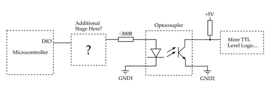

I frequently work on projects in which I use optocouplers for isolating digital +5VDC control signals (for example, from a microcontroller) from the rest of the circuit. However, since these work by illuminating an LED inside the device, there can be several tens of milliamps load on the microcontroller pins. I am looking for advice on what would be the best practice for buffering this control signal with an additonal stage, so that the microcontroller effectively sees a high impedance, and thereby reducing the current that it needs to provide?
Just naively off the top of my head, I can think of a few things which might work:
  1. Simply use an op amp as a unity gain buffer amplifier.
  2. Use a dedicated comparator chip to compare the input signal with, for example, +2.5VDC.
  3. Use a MOSFET as a kind of signal amplifier.
However, upon doing some reading, I have come across a whole bunch of chips that I have never used before, but sound like they may be designed for this kind of thing. For example:
  • A Differential Line Driver (MC3487)
  • A Differential Line Receiver (DC90C032)
  • A Line Transceiver (SN65MLVD040)
  • Buffer gates and drivers (SN74LS07, SN74ABT126)
I really have no experience with any of these and am a little overwhelmed by the amount of stuff available! So can anyone help me to learn the differences between these devices, and which ones of them would / wouldn't be suitable in this case. Is there a best / standard way of achieving what I describe?
edit:
Since I could be switching up to around x30 outputs, I do not want to be concerned at all about loading the microcontrollers, and so will not be considering connecting directly to the DIO pins. Therefore, I think I will go for a logic buffer IC. I am going to try using the SN74LVC1G125 "Single Bus Buffer Gate With 3-State Output" for each input, and see how that works out.

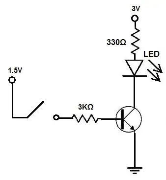

A simple BJT like MMBT3904 or any switching BJT will do the job. You can get a reel of 100 for two bucks.

The differential line drivers are not designed for driving LEDs. These buffer chips drive (or receive) a differential signal on two wires. The voltage swing may be 1.3 volts to 1.7 volts. Not enough to turn an LED on or off.
The TTL buffers are ideal for this application, but rather than connect to the high side of the LED as drawn in your schematic they should connected to the low side of the LED, since TTL is good at sinking current and poor at sourcing current.
However if you have only a few optocouplers to connect then a NPN BJT is an even simpler way to drive the LED.
