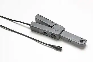

To measure current you could measure the primary current in the power supply to get a reasonable indication (though it includes current due to output power plus current due to power losses in the transformer) of the total power consumed. Something like this for your Fluke should work:

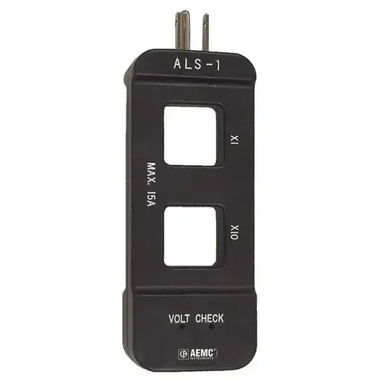

Personally I use a Tenma 72-6130 multimeter with an inbuilt current probe. I also use an ExTech/AEMC ALS-1 mains line splitter/breakout with X1 and X10 current loops to make current measurements very easy. There are a slew of line splitters available, and they are very cheap.

  • A second meter might be convenient, but certainly not required. The probe should never be permanently attached to a measuring point, it's meant to be manually used. The current probe can be permanently attached to a mains lead. It's double insulated and is not a direct connection. – Jack Creasey Sep 15 '17 at 15:29
