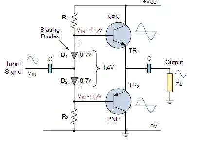

  1. Signal connected between biasing diodes with single decoupling capacitor: Class AB with Diode bias

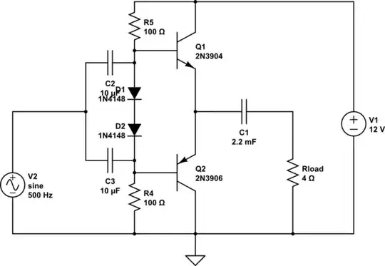

  2. Signal connected directly to each transistors base with separate capacitors:Diode bias with two input capacitors
What is the practical difference between these two approaches? Is one better than the other?
Here is an editable circuit showing the basic idea of the 2nd approach (NB: values are not that realistic):

The purpose of the diodes is to set a bias voltage between the transistors' bases, which sets a small idle current through the push-pull. This makes it work in class-AB and lowers crossover distortion. However the diodes should be thermally coupled to the transistors, to prevent thermal runaway. Also, emitter resistors should be used for this reason.
Anyway.
As long as both diodes conduct, say a few mA current through the diodes, their dynamic impedance will be rather small, like 10-20 ohms, so the transistors will be driven from a low impedance. What matters here is that this bias current is generated by resistors R1 and R2.
So, when we want high positive output voltage (and presumably high output current) voltage on R1 will be low as TR1 is driven to a voltage close to the positive power rail. Since TR1's base current comes only from R1, this is a problem: for a high enough output current, TR1's base current will suck out all the current R1 can provide, so D1 will turn off and it no longer works.
The second configuration will work better if the two input caps are large enough to have low impedance at the frequency of interest: in this case, AC base current is provided from the signal source through the caps, and R1/R2 only set the DC operating point.
Thus the second configuration is a better choice, if the extra performance is required. It would also allow higher values for R1/R2 since it solves the problem of the resistors having to be small enough to let enough current through for the base current required for maximum output current.

    I agree with this answer, in most commercial amplifiers R1 and/or R2 are current mirrors meaning that the AC impedance to ground is higher compared to using resistors. In that case the difference between both solutions will be very small so to save a capacitor you would most often see solution 1. Sometimes also a capacitor is placed in parallel with each diode making it behave a little more like solution 2. But again, the difference is not much. – Bimpelrekkie Sep 13 '17 at 19:41
    Yeah, here the resistors are required to set the DC operating point because the AC-coupled input can't. This isn't such a good idea IMO, the push pull runs open loop so distortion will be quite high. Still useful in some circumstances, but... well, mehhh. Also having caps between the bases helps sucking the charge out of them, which is very useful to prevent post-clipping cross-conduction. – bobflux Sep 13 '17 at 20:18
  • @peufeu: Thanks. I'm trying to build/understand this circuit mostly as a learning exercise . So diodes thermally coupled, Emitter resistors (small values, yes?), separate input caps of suitable size (10uF?), cap for each base (this is what you mean by "caps between the bases", yes?), and eventually NFB (adding a 3rd transistor to drive the bases). Anything else? – Frosty Sep 13 '17 at 20:59
  • Yes, you can add 1-3 ohm emitter resistors to prevent thermal runaway. – bobflux Sep 13 '17 at 21:16
  • 3 ohms means almost half power loss with 4R load and poor dampening ratio – Tony Stewart EE75 Sep 15 '17 at 19:30
  • The "power transistor" is a 2N3904 so... good luck with a 4R load ;) – bobflux Sep 15 '17 at 19:53
  • It says "not all that realistic" right on the package, @peufeu ;-). It is only something to play with... – Frosty Sep 15 '17 at 21:04
  • Hmmm... wait... oh... yeah... it's Op's problem :) – bobflux Sep 15 '17 at 21:31
