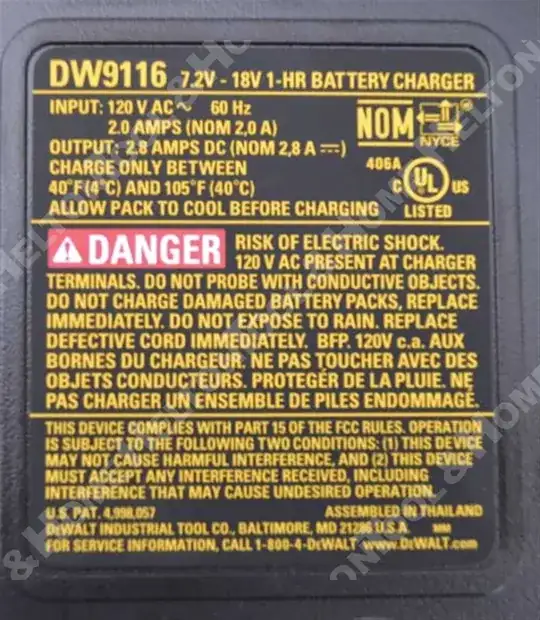

The charger from Dewalt is only rated at 18V with a current rating of 2A. enter image description here Dewalt DW9116 7.2V - 18V NiCd Battery Charger New for DW9057 DW9094 DC9071 $34.90 Ebay.
The fact that you need to drive 24V just to get 0.7A indicates your batteries have aged significantly and are on their last legs.
