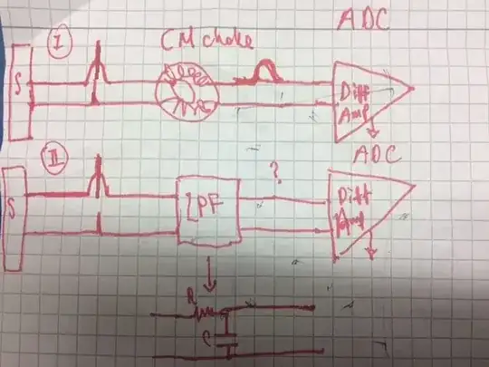

Below are two scenarios where an isolated(floating/battery powered) sensor S signal is measured by an ADC device and the system is single ended. The coaxial cable’s two wires somehow are victim of CM noise. As you see the CM noise is the spike superimposed on the half sine wave desired signal: enter image description here
So in the first scenario(upper diagram) I can see how the CM blocks this spike now. But in the bottom diagram there is an attempt to remove the same spike with a LPF where the LPF’s ground is the signal ground as usual. Will this attempt also remove the spike or not?

  • Please see my edit I could express the core of my confusion: So in the first scenario(upper diagram) I can see how the CM blocks this spike now. But in the bottom diagram there is an attempt to remove the same spike with a LPF where the LPF’s ground is the signal ground as usual. Will this attempt also remove the spike or not? – user1245 Sep 13 '17 at 11:14
  • I don't understand the relevance of the low pass filter comparison in your question. As far as I am concerned the basic question is answered irrespective of your edit but please do elucidate if you feel I've misinterpreted what your edit is all about. – Andy aka Sep 13 '17 at 11:38
  • I was wondering why they use choke for CM noise instead of a LPF. This lead me to ask this question. I would be glad if you have a comment on my edit. – user1245 Sep 13 '17 at 11:40
  • A low pass filter only filters differential line signals. It doesn't filter signals that appear on both lines. And, conversely, a CM choke doesn't filter differential signals i.e. a difference voltage at the input will appear at the output largely unaltered. Different beasts doing different jobs. – Andy aka Sep 13 '17 at 11:58
  • So in my figure II the spike will pass and the LPF will be useless right? I tried to remove a 50Hz noise once with a similar setup like in figure II(with proper cutoff), maybe that was the reason it didnt work. So CM noise cannot be filtered by a LPF like a usual line signal noise. I hope I got it, let me know if what i wrote is not correct. Thanks. – user1245 Sep 13 '17 at 12:02
