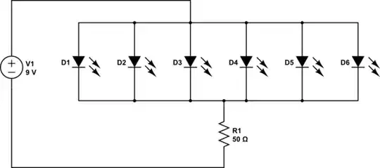

But I felt the above schematic is so bulk due to the presence of resistors, So I am thinking to replace the above one with something like this below.
simulate this circuit Am i doing it right in simplifying the circuit? Kindly advice.

    Nope. This is not appropriate because the LEDs have slightly different forward voltages (even if they are the same part number) and so one ends up with passing current than the rest. – Tom Carpenter Sep 10 '17 at 14:11

    @TomCarpenter The 4 LEDS in parallel does have an answer that is pretty much correct ...but it's not the one selected final. No LEDs will 'pop', no LED will hog current, they balance because the LEDs have and effective series resistance that is a large percentage of the series resistor. The OP will be fine doing this. A great example is the millions of Chinese LED torches that do this, and these are very reliable with up to 20 or 25 LEDs in parallel. – Jack Creasey Sep 10 '17 at 14:30
Yes you are able to do what you propose. There will be current differences between the LEDs, but it's unlikely that you will be able to see the difference. No LED will hog all the current, no LED will go into thermal runaway, and no LED will 'pop' and cause catastrophic failure. You can do simple tests to ensure that your LEDs are within a reasonable Vf range.
One comment suggested this previous answer, but unfortunately the answer selected as correct is wrong. Look at the answer from Stevenvh .....that is correct. From this answer you can see that the LEDs need to be the same (part number at least) and with this caveat the differences between the LEDs will result in current/power differences of only a few percent when many are paralleled.
There are many millions of LED Torches that use this technique and have up to 20-25 LEDs in them with a single series resistor. They don't blow up, they don't thermally runaway.
One note for you though is that you don't need to use a 9 V battery. In this configuration you are wasting battery energy. If your LEDs were 3 V Vf precisely (which I bet they are not), then you are dissipating about 700 mW in the resistor (one or many it's the same) and only 360 mW in the LEDs.
Note: It would be much better to use 3 * 1.5 V batteries. With this configuration and a series resistor of 12.5 Ohms (to give the 120 mA total current) you would then dissipate only 180 mW in the series resistor.

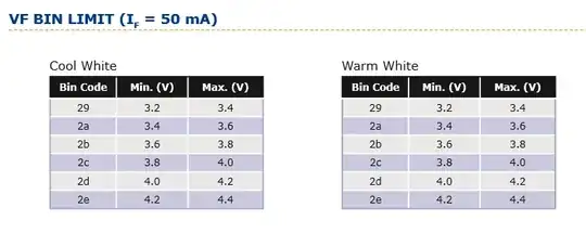

Do you need bin'd components? You can pay extra for LEDs that are sorted to provide a lower variance (in Vf, color and light output), but for most DIY'ers this represents a potentially expensive option. However you can simply do a single point check for each LED you have, using a resistor to limit the current. If you measure the Vf at your target working current (say 20 mA) you can sort for differences in the LEDs Vf. I normally buy cheap LED on Ebay (by the 100) and find only about 50-100 mV maximum variation. It's easy to select 5-10 LEDs from the batch within just a few mV of each other at any given operating current. You could for example sort 100 LEDs into say 20-50 mV groups and chose to select a series resistor value for each group if you were concerned (still much less than a resister per LED).
For example, here is a CREE datasheet for a White LED. Notice in the bin'ing that the majority of selection is done for color, but there are Vf bins:
This clearly shows that you would have serious trouble with a parallel configuration if you had a range of Vf with some at 3.2 V and some at 4.4 V. However, buying all from one bin gets you to only 200 mV Vf range.
Reference to the datasheet again shows the typical forward current related to Vf: enter image description here
This is a typical curve ....here you would consider a single LED would be like this, and the datasheet shows VF @ 50 mA for the bins. So on this typical curve the LED Vf is about 3.8 V. If you had another LED from another bin you'd have a separate curve centered around 50 mA. Here I've fudged the graphic to show the maximum variation of bins:
Notice that if you put three LEDs with Vf bin values 3.2, 3.8 and 4.4 in parallel you'd have current values of approximately 75, 50 and 20 mA respectively in the LEDs. Variation for sure, but unlikely to pop or have thermal runaway become a problem.
So it's definitely worthwhile to ensure your LEDs Vf are within say 100 mV of each other to ensure that the current balance (or nearly so).
With some minimal testing you could preclude outliers and select LEDs well within a working range (say no more than 100 mV variation in Vf) that can be paralleled very successfully.

Your LEDs aren't identical: one of them will have a lower Vf than the others, so it will draw more current, then heat up, which lowers its Vf and makes it draw more current...
Until it pops, and then the next LED with the lowest Vf goes through the same...
One resistor per LED is best.
However, you can put the LEDs in series, which ensures the current in each is equal. If you start with 9V, then you can put 3 red LEDs (Vf=1.8V each) in series, which makes 5.4V, and a resistor. Or 4 LEDs, but when the battery is low they will be dim.
