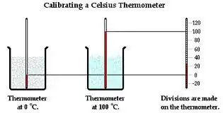

Calibrating a thermometer.
Using 0ºC and 100ºC isn't as good as using, say 50ºC and 80ºC, but it's a lot easier. If you do have a very accurate thermometer available, then you should use calibration points closer to your cooking temperature.
