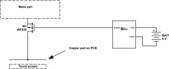

Here is my first design idea: a first prototype would consist of a grid of copper pad on a PCB, like on the following picture.
Each copper pad could be connected with a transistor to a metallic mass that would simulate the fingertip capacitance. Obviously each transistor would be commanded by the MCU comprised in the device.
However I don't have any idea if this design would work. What I can't figure out is how I should connect my battery to the metal part and/or the copper pad, and how big should my metal body be to yield enough capacitance to the device to be detected by the touch screen.

I'd suggest that you will have too much capacitance in the FET to give reliable results.
When the FET (and I'd use P-Chan in your circuit) is off there is typically hundreds of pF of output capacitance.
I'd use a Reed Relay where the open circuit capacitance is extremely low, just a couple of a pF maximum. This gives you the maximum possible change in capacitance to be recognized by your touch matrix. I'd also use round capacitor targets rather than square.

  • Thanks for your answer! I didn't know the Reed relays. I guess I would need one by capacitor target, right? Do you have any idea if I can avoid the GND plane below the DUT, and just use a big enough piece of metal as alternative ground? – Vincz777 Sep 07 '17 at 19:28
  • A metal backing would suffice for the backplane, and yes you would need one reed relay per capacitive target. – Jack Creasey Sep 07 '17 at 21:41
