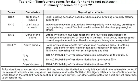

Of course and it is disciplined by different standards in different countries. I am used to IEC standards, so IEC 60479-1 is the reference for current-duration limits, distinguishing between perceivable intensity, peripheral muscular effects, more serious effects, e.g. on heart, injury, death. See IEC 60479-1 Figure 20 and 22 below for ac and dc systems, respectively, and Table 11 and 13, again for ac and dc, for interpretation. enter image description here enter image description here ... enter image description here enter image description here

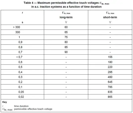

To simplify, if limits only are considered, we may have different voltage-time curves, where lower voltages are tolerated for longer times. EN 50122-1 tables for ac and dc systems follow.
