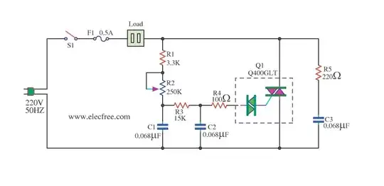

You were right, all the schematics on google were either quite outdated or not really compatible.
This timeless classic has two issues: unlike a comparator, the diac will discharge the capacitor on every triggering, and the voltage on the diac and gate is AC, so we can't make a ramp by charging a capacitor, because this requires DC.

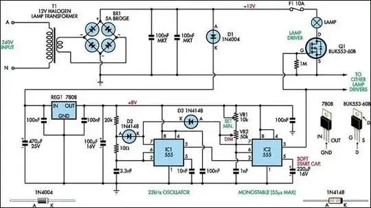

Some people got creative:
Here we have a rectifier, charging a capacitor with a ramp, then a P.U.T no less, acting as oscillator and driving the triac gate through a pulse transformer. Two components which should be difficult to source...
One solution would be to put the whole thing inside a diode bridge, so we're able to work on DC... although this one isn't a soft start, but you get the idea. However, I'd like the switching noise to stop completely after the soft-start is finished.
Of course, everyone would use a microcontroller, these days.
This one has a transformer because it's for low voltage bulbs. But it uses two 555s to create a PWM, also a voltage regulator... so high tech!
