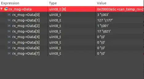

When I tested this same code in a car the response I got was not in accordance with what I received while testing. I tested for two cases:
1. Requesting a single ECU (0x7E0) for its supported PIDs
2. Using a broadcast request (0x7DF)
In case 1
The response I received:
I can't understand what each of the bytes represents.

  • I cannot answer your questions, but Case 1 shows an error response: 0x03 0x7F 0x01 0x11 (length, error ind, pid, error#) meaning Service not Supported Using a request with ID 0x7E0 might conflict with an existing ECU. As I understand it you cannot address a specific unit by its ID. Issue a request (using a unique ID) and the right unit will answer or no one will. – Rob Sep 11 '19 at 19:31
