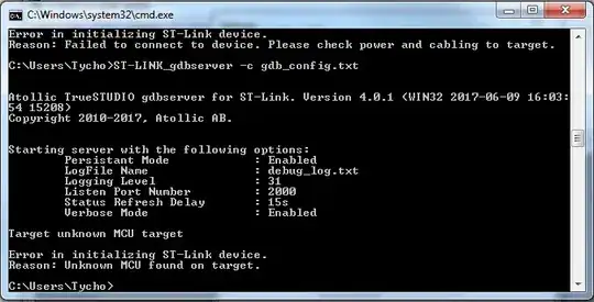

After this, I also tried to run the ST-Link_gdbserver to see if I could get a different response, but all I got was the following:
"Target unknown MCU target
Error in initializing ST-Link device Reason: Unknown MCU found on target"

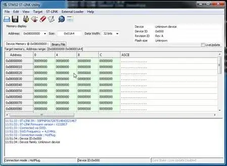

On the other hand, when trying the ST-Link utility, when running from "Normal" or "Connect Under Reset" mode, the utility pops a message saying stating:
"14:53:37 : Can not connect to target! Please select "Connect Under Reset" mode from Target->Settings menu and try again. If you're trying to connect to a low-frequency application, please select a lower SWD Frequency mode from Target->Settings menu. 14:53:41 : Can't halt the core"
But, when running on Hot Plug mode, a connection is made available. What's interesting is that the Device ID is not recognized, nor is the Device Family.
Although the FLASH memory cannot be erased due to a Read Out Protection, this read out protection cannot be disabled with "Option Bytes", an error message pops up stating
"Could not set Option Bytes!, Please reset the target and retry"
I believe the debugger can't recognize the MCU, and therefore a read out protection is interpreted somehow.
