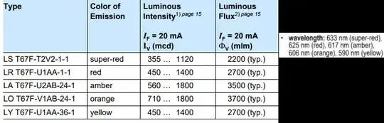

Let's plug in an example: I've chosen the Osram Top LED and we can have a look at the different colors they are offering. The nice thing about this datasheet is, they give the luminous flux and luminous intensity, which we will visit in the next step. I wasn't able to find a datasheet which gives luminous flux and radiant flux - I guess that wouldn't be worth the trouble for the manufacturer.
Luminous values and wavelength
Actually, and that's quite remarkable, Osram provides two wavelength figures. The one of the emitted wavelength and the dominant wavelength. As you can see the dominant wavelength is smaller, because of the form of the weighting function, our eye will "prefer" the wavelength nearer to 555 nm. We have to take the emitted wavelength for calculation, but I'm not sure how other manufacturers handle this. Well actually as long as we assume a single wavelength we always end up with some approximation.
Actual wavelengths
And to do the calculation, we need the table for the luminosity function (sheet 1931 col observer column C).
Which gives us (linear interpolation, and datasheet values):
  • 645 nm: 0.1382, Vf = 2.05 V, If = 20 mA, P = 41 mW, \$\Phi_v\$ = 2.2 lm
  • 634 nm: 0.2266, Vf = 2.05 V, If = 20 mA, P = 41 mW, \$\Phi_v\$ = 2.7 lm
  • 624 nm: 0.3330, Vf = 2.15 V, If = 20 mA, P = 43 mW, \$\Phi_v\$ = 3.5 lm
  • 610 nm: 0.5030, Vf = 2.15 V, If = 20 mA, P = 43 mW, \$\Phi_v\$ = 3.7 lm
  • 597 nm: 0.6693, Vf = 2.20 V, If = 20 mA, P = 44 mW, \$\Phi_v\$ = 2.7 lm

With the Osram LED as before we get a range of candela in the datasheet and the apex angle of 120°:
  • 645 nm: 0.355 ... 1.120 cd, mean: 0.7375 cd
  • 634 nm: 0.450 ... 1.400 cd, mean: 0.9250 cd
  • 624 nm: 0.560 ... 1.800 cd, mean: 1.1800 cd
  • 610 nm: 0.710 ... 1.800 cd, mean: 1.2550 cd
  • 597 nm: 0.450 ... 1.400 cd, mean: 0.9250 cd
So we first calculate our solid angle: \$\Omega = 2 \pi (1 - \cos 60°) = \pi ~\text{sr}\$ - that was easy for once.
And with that we get:
  • 645 nm: \$\Phi_v = 0.7375~\text{cd} * \pi~\text{sr} = 2.32~\text{lm}\$
  • 634 nm: \$\Phi_v\$ = 2.9 lm
  • 624 nm: \$\Phi_v\$ = 3.7 lm
  • 610 nm: \$\Phi_v\$ = 3.9 lm
  • 597 nm: \$\Phi_v\$ = 2.9 lm
Which is more than what is given as typical value by Osram, but it's not very far off. I mean, the range given for the luminous intensity is huge and just taking the mean without knowing how their production varies is just a guess. Maybe keep this result in mind and take a bit less than the mean in future.
