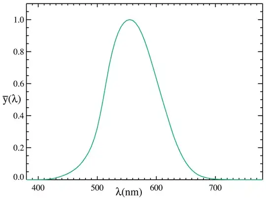

Now the problem arises, that we cannot see all colors equally well. And lumens are actually weighted based on the response of our eye:
Public Domain, Link
So with this, you can create some values of upper bounds (based on the redefinition of the unit candela). This would be the luminous efficacy of radiation.
