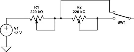

I assume this isn't possible except by placing another variable resistor on a circuit path, as so:
This would require a design that forces keeping the two potentiometers physically aligned, though. If there's some trick to do this where one potentiometer will automatically 'track' the other one, I'd like to use that.

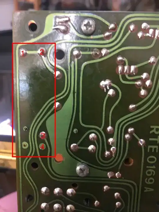

Edit: Per questions, here's a photo of the PCB: PCB showing connections

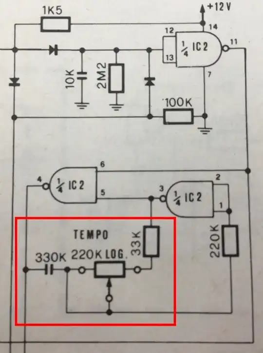

And relevant part of the circuit diagram: Photo of the circuit diagram

With the newly added original schematic, we can see that this is a RC oscillator circuit. To achieve your real goal of adding a half tempo switch, we can divide the tempo in half by adding a second capacitor with the same value as the original one. With the switch the resulting circuit segment would look like this:
When the switch is closed the capacitance is doubled, which means the frequency is halved. That sounds by far like the easiest option here - much easier than replacing the potentiometer with anything.

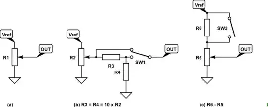

It is very unlikely that your system is configured as shown in your schematic. With the leftmost active pot wiper fully left you short out the voltage reference.
Figure 1. (a) A more likely arrangement in your rhythm box. (b) Dividing the output by two. (c) Dividing the input by two.
  • (a) shows the likely arrangement. Note that the load on Vref remains constant no matter where the wiper is set. (This assumes that the load on OUT is fairly high resistance so that it doesn't load Vref significantly.)
  • (b) divides the output voltage by two. Since your downstream circuit will have some loading effect you may find that this does not quite give you half the frequency. R3 and 4 need to be about ten times the pot resistance value to avoid loading it too much or the voltage will droop.
  • (c) is very simple. Use the potentiometer resistance track as half of a potential divider. This should be the simplest to implement too. It may just require cutting the track to the "top" of the pot and adding the series resistor and single-pole, single-throw switch.
Your modified schematic still shows series connected variable resistors. You have forgotten to connect the wipers to one end of the pots. At the moment they do nothing as they are open circuit.
simulate this circuit
Figure 2. Stereo potentiometer arrangements. (a) What the OP intends. (b) This circuit will not work in the OP's application.
  • Figure 2a will only work if the original potentiometer is wired not as a potentiometer but as a variable resistor or "rheostat". This may be the case but is unlikely. Note that you can simplify this further by simply shorting out one of the pots using an SPST switch rather than an SPDT type.
  • Figure 2b will not work as the result would be a square-law. Fully clockwise the output would be 100%. At mid-position the output would be 50% x 50% = 25%.
To resolve your problem you need to reverse engineer the circuit to understand how the original potentiometer is being used.
Your latest edit shows you had the schematic all along. Oh, man!
Figure 3. The resistor solution based on the original design.
We can see from this that it is a heap of trouble. @KevinCathcart's solution is the way to go.

  • Is the wiper of the original pot actually connected to one end of the pot as you have shown? You should be able to trace this on the PCB or measure the resistance from the wiper to each pot end with wiper set at 50%. If my hunch is right you will find one end of the pot permanently connected to the ground plane. You can confirm this by multimeter as well. – Transistor Aug 21 '17 at 13:40

  • @Transistor thought I'd lost the 'real' schematic— spent ages digging it out today! :) – buildsucceeded Aug 21 '17 at 21:38
  • Can you expand on why the solution you've posted is 'a heap of trouble'? I have no idea and it would be helpful for me to get a bit of advanced insight into this. – buildsucceeded Aug 21 '17 at 21:39
  • (1) You'll have to remove the existing pot and put in a stereo version. (2) It's a logarithmic pot. You might find that the two pots in a stereo version don't track that accurately and you won't get an exact halving of frequency. (3) You'll have to cut a trace to insert your new components. It's doable but isn't as elegant as the double-capacitor job. If I was doing that I would probably replace the original with another from the same batch as the additional capacitor in the hopes of getting a good match between the pair. – Transistor Aug 21 '17 at 22:17
  • I've seen audio circuits that tie the wiper to one end of the pot a few times before. By capping the maximum resistance if the wiper runs over a speck of dirt it is supposed to reduce noise in the output. This of course is more of an issue with slide pots than rotary – Chris H Aug 22 '17 at 12:32
  • Yes, it is standard practice to do that. Whatever about noise, it prevents the circuit going completely open if wiper contact is lost. The oscillator would stop in this case. Instead the circuit will oscillate at the minimum frequency. – Transistor Aug 22 '17 at 12:48
