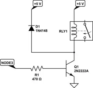

Time to prepare a schematic:
The value of \$R_1\$ is pretty simple to compute. First, assume that the I/O pin is operating at its lowest output voltage when high. You already know this value from above, \$\ref{voh}\$. Also, you know the typical value for the base-emitter voltage of the BJT from above, \$\ref{vbe}\$. And finally, you also know the likely base current, \$\ref{ib}\$. So just compute: $$R_1=\frac{2.64\:\textrm{V}-800\:\textrm{mV}}{4\:\textrm{mA}}=460\:\Omega\label{r1}\tag{R1}$$
The nearest value would be \$470\:\Omega\$. So that is what you see in the schematic. The diode, of course, provides a path for the relay's magnetic field energy to collapse, when you try to turn it off. It otherwise doesn't conduct.
Say your I/O pin is more powerful than we assumed and holds a full \$3.3\:\textrm{V}\$ when driving high. Then the I/O pin and BJT base current will be \$\frac{3.3\:\textrm{V}-800\:\textrm{mV}}{470\:\Omega}\approx 4.4\:\textrm{mA}\$. This is also just fine and won't hurt anything at all. So this design should work well.
There are reasons for adding a resistor to ground, from the BJT base. One is that it helps keep the base near ground if for some reason the other end of \$R_1\$ were floating and not connected to your ESP8266. And there are other reasons. But it's not vital here, so I'll leave out the discussion of it for now.
EDIT: With you indicating (in comments below) value of \$100\:\textrm{mA}\$ for the relay, which is 2.5 times as much as I'd used above, you could consider the idea of using 2.5 times the base current. But also most of these small signal BJTs can work well as a switch with higher values of \$\beta\$ than I earlier suggested from reading Figure 11. Let's look at Figure 4, now:

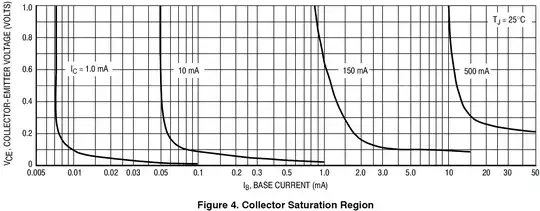

Here, you can see a curve labeled \$150\:\textrm{mA}\$, which is more than you need. The x-axis is the base current \$I_B\$, and the y-axis is \$V_{CE}\$. You want a low value for \$V_{CE}\$ and you can see that it plateaus out at around \$100\:\textrm{mV}\$. Keeping in mind that these are typical curves and not guaranteed curves, you can see that using \$I_B\approx 8\:\textrm{mA}\$ looks pretty solid (far away from the curve knee) and that \$10\:\textrm{mA}\$ is even better. Well, this suggests that \$\beta\$ from about 15 to 20 is probably going to work pretty well.
Taking all this together for your relay at \$100\:\textrm{mA}\$, you need about 2.5 times as much base current because of the increased relay load but you can afford to drop it by a factor of from 1.5 to 2.0 because of the Figure 4 curve. So perhaps going from the earlier computed \$I_B=4\:\textrm{mA}\$ to perhaps \$I_B=5\:\textrm{mA}\$ to \$I_B=6.7\:\textrm{mA}\$ is just fine.
Let's re-compute the earlier equation for \$\ref{r1}\$: $$R_1=\frac{2.64\:\textrm{V}-800\:\textrm{mV}}{5\:\textrm{mA}}=368\:\Omega\label{r1x}\tag{R1 redo 1}$$
$$R_1=\frac{2.64\:\textrm{V}-800\:\textrm{mV}}{6.7\:\textrm{mA}}=275\:\Omega\label{r1y}\tag{R1 redo 2}$$
Between these two? I'd just go with \$R_1=330\:\Omega\$. I think that would be sound. Worst case I/O pin current should be approximately \$7.5\:\textrm{mA}\$. This is well below the maximum of \$12\:\textrm{mA}\$ for the ESP8266 datasheet table I show above, but enough under it that I wouldn't be too concerned. (At least, not unless I knew I was repeating this driver across a large number of I/O pins. In that case, I'd probably go look to see if there was a specified limit for the port or device as a whole.)
