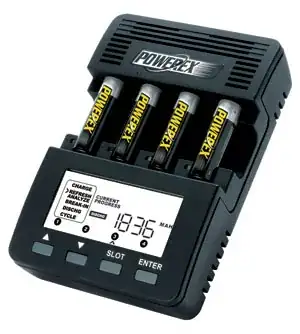

The very capable (and 'nice' :-)) "Powerex Maha MH-C9000" charger charges 4 x AA or AAA cells completely independently - cells can be charging or discharging or resting and the charger can be programmed to perform test cycles or "reconditioning" cycles and more. This is an excellent example of what a charger can achieve when absolute minimum cost is not the main driver.
http://www.mahaenergy.com/store/catalog/mhc9000.jpg
At about $70 here (price varies with seller) this is a very expensive charger compared to most - and also very good value for money if you use AA rechargeable cells extensively.

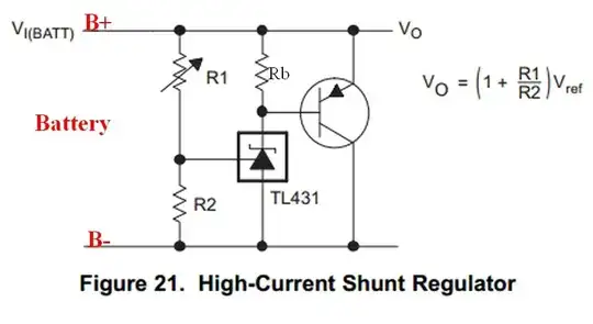

Multi-cell-string charging:
I've not seen it done (but it may be) but a relatively simple circuit per cell would allow you to charge NimH cells in a series string with little or no ill effects.
Across each NimH cell place a 1.45 Volt shunt (or clamp) regulator. For extra points temperature compensate it, but the difference is small enough to be bearable in most cases. Circuit below - Vout goes nowhere. Battery connects across two rails. Circuit bypasses current when Vbattery reaches present level. Cost at one off levels is $0.50 - $1.00 worst case per cell. Component cost in manufacturing volumes is 5 to 10 cents per cell.
Two diodes would be cheaper but have a far less sharp "knee" and would not be programmable. TL431, R1, R2 could be replaced by a zener but cutoff knee would be very soft.

  • You can make a simple discharger that works in parallel that leaves cells at a safe level and then charge them from there. NimH or NiCd Cells discharged to say 1V will be reasonably empty. NB NOT just a resistor - rather a sink to a known voltage - one per cell with regulator would be good BUT using some diode arrangement would do. Something like 1 x Schottky + 1 x silicon diode in series per cell - but will need tailoring. – Russell McMahon May 24 '12 at 05:05
  • @RussellMcMahon, that assumes the batteries have the same capacity. New ones do, but as they age, the capacity does not change equally for all cells (differences in manufacturing, maybe one cell has more cycles or was in higher temperature etc), which would still leave one cell overcharged and one undercharged. Also, a diode still passes current even though the voltage is lower than the stated forward drop voltage, so the battery can still be discharged too deeply (I tried to use a few diodes to drop the voltage of a power supply to charge batteries, ended up slowly overcharging them). – Pentium100 May 24 '12 at 05:21
  • @Pentium100 - I'm not sure which part of my response you are referring to - you seem to be agreeing with me :-). In my clamp/shunt regulator add-on I specify a TL431 IC driven circuit - don't be fooled by the symbol - it's effectively a programmable zener and that circuit will change from under 1 mA to say 2000 mA clamping within say 10 mV battery Voltage increase, if desired. The 1.45V terminal voltage is about right for most NimH cells so you can use modestly age-wearied cells without much worry. I mentioned diodes and zeners only to say that they were not really good enough. ... – Russell McMahon May 24 '12 at 06:51
  • @Pentium100 - ... Using a per-battery clamp at 1.45V you **COULD** even charge say a 1000 and 2500 mAh in series at 1000 mA charge rate !!! This would be unusual but would charge the 1000 to full capacity and then clamp the 1000 mAh cell at full voltage while the 2500 completed charging. The excess energy bypassing the 1000 mAh cell would be wasted as heat energy in the shunt. – Russell McMahon May 24 '12 at 06:53
  • @RussellMcMahon, I did not see the addition to your answer, so was replying just to the comment. Now that I read the addition, I agree with you. – Pentium100 May 24 '12 at 15:23
