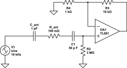

This kind of antenna is sometimes called electric-field probe antenna. Here's an extremely low radio frequency preamp example. The antenna itself can be quite short, but must be physically placed well above adjacent structures, trees etc. Since the self-capacitance of the antenna is quite small, the high-impedance preamp must be placed right at its bottom end: ultra-low-frequency electric field probe Were you to model this circuit in a SPICE simulation, the antenna would appear as a tiny capacitor in series with a tiny resistance:
