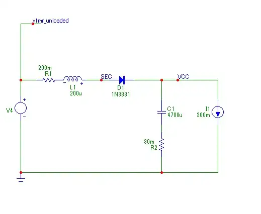

ANOTHER EDIT

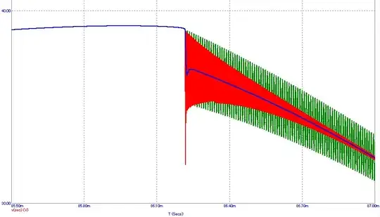

When the oscilloscope disagrees with the simulator, one or both could be wrong, however it always helps to model the real circuit (ie, account for transformer inductance) and watch the sim parameters...
This works as expected. Due to transformer inductance (current lags voltage), the diode turns off a little bit later than what would be expected from visual comparison of transformer unloaded voltage (black) and capacitor voltage (green). A perfect diode would also turn off at the same moment, then the transformer secondary voltage would snap back down to its unloaded value. This is normal.
What recovery adds is a tiny amount of time for diode current to turn negative. Thus, when the diode blocks, inductor current is not zero, rather it is a few mA. This is not a lot, because 50Hz is very slow.
However, when the diode turns off, the inductor is large enough to produce a sharp negative voltage spike which causes ringing in the LC tank formed by the inductance and the diode's capacitance, which is an EMI problem.
In real life, the ringing is much shorter than shown here, because the inductor has lots of losses at high frequency. Here it rings at about 1MHz.
Using faster diodes (low Qrr) makes them turn off at a lower negative current, so it reduces the amount of energy available to excite the ringing. Soft recovery diodes produce a smoother current step, which has the same effect. So, fast/soft recovery diodes work to reduce EMI problems here. But a cheaper fix is to just put caps across the diodes. It works just as well.
Red trace is without caps and without snubber. It rings at 1MHz. Adding 10nF cap across the diode lowers ringing frequency to 100kHz (green) which is no longer a problem, it also smoothes the edges, so the EMI problem is gone. Blue is with snubber added (R3/C3). Much cleaner, but not strictly necessary. Transformer iron losses would mostly dampen it anyway.
Summary: Superfast diodes cause less noise, but it's only because of a subtle side-effect: they let less current (and energy) build up in the inductor before turning off, at which point inductor stored energy is turned into ringing. Absorbing the inductor energy in a capacitor and dissipating it in a snubber resistor is just as good, in fact it works better for less money... which means there is no real cost/benefit gain for expensive superfast diodes. But they work. They're just not the optimum solution.
