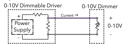

The following diagram is representative of this circuit. The power supply (dimmable driver) is on the left, and the dimmer I would like to build (the controller) is on the right.
There are many analogue controller options available for a dimmer, but I would like to create a digital dimmer using an ESP32 and I²C.
This is where I'm running into a problem. I've found a number of I²C controllable rheostats at DigiKey and elsewhere, but almost without fail their datasheets say the maximum allowable voltage across the rheostat pins is very close to the Vdd that supplies the rheostat IC. Since I'm looking at a Vdd of 3.3V, the maximum allowable voltage is around 3-3.6V, which is completely outside the 0-10V range I need to control.
I found another IC with two supply rails that looks like it might work, the MCP45HV31-104E but as far as similar devices in its product category there are very few, which makes me wonder if I'm approaching this problem from entirely the wrong way (I have a lot of software experience but very little electronics experience unfortunately).
So my question is am I looking at this the wrong way? i.e. is there a different way to hook up a "standard" digital rheostat (one with a voltage range near 3.3V Vdd) such that I can get the full 0-10V range out of it?
Or do I need something like the MCP45HV31-104E to implement a dimmer?

  • Looks like the standard you referenced linked to another standard. That standard says "input impedance shall be a nominal \$100\:\textrm{k}\Omega\pm\$20%" but then also notes that since the controller output might drive multiple receivers, it may need to drive lower impedances. You need a 10 V source voltage available to your ESP32. You can either "pump" it up with software (which works) from your existing supply, or else you can buy such an added power supply. If I were you, I'd just wire up a simple pump and operate it in software. It doesn't need to source a lot of current. – jonk Aug 08 '17 at 18:49

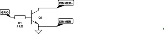

Figure 3. Interface between micro-controller and dimmer control.
See if you can generate a variable duty cycle dimmer signal with your micro. You can't do any harm as the transistor can only short the 0.5 mA current source to ground as though your pot was turned to minimum.
