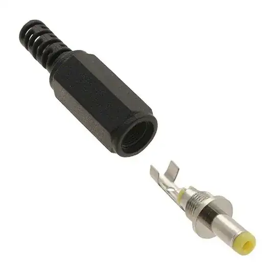

I need to modify the DC connector on about 100 AC/DC power supplies and will be installing a barrel connector like this: enter image description here
I would like to make the connector more permanent and prevent a user from opening the connector as well as increase the physical bond between the wire and the connector. I'm thinking I would like to squirt a blob of some compound (potting compound?) before threading the connector back together to lock it all up.
Is there an appropriate compound for this application?

For casual use, from the Amateur Radio Relay League Hints & Kinks, just using a good grade of hot glue should do well, and can still be removed. For permanent use try 2-part epoxy like JB Weld, it can even be machined after drying.
user159043
  • 51
  • How do you propose to inject the hot glue into the connector? If over an opened yet connector, then the glue will cool off fast, and you won't be able to screw to plastic body in. – Ale..chenski Aug 04 '17 at 23:10
