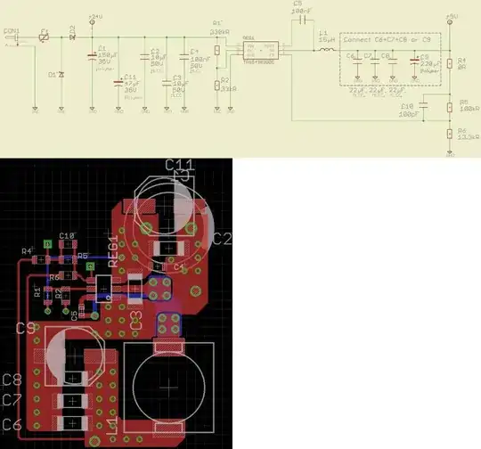

I am currently building a buck converter. Its main parameters are the following:
  • 24V input
  • 5V/3A output
  • Able to sustain large load transient currents caused by the switching of power LEDs (~2A)
I selected a synchronous buck converter from TI which fits my needs in terms of electrical characteristics, package and cost: the TPS54302. The first prototype was designed following the datasheet recommendations and formulas. The routing of the PCB was done imitating the converter's evaluation board.
Here are the schematics and CAD:
schematic diagram and PCB layout
(4 layer board, layers 2 and 3 are hidden. They respectively contain GND plane and supply plane)
There are additional capacitor footprints on this design to be able to test different component configurations.
When I actually tested the board, I was satisfied with the main characteristics: efficiency, output current and voltage, input and output ripple.
However, I wanted to test the stability of the power supply and this is where I started observing unexpected behaviors. I don't have any network analyzer or signal generator available, preventing me from measuring the phase margin. Instead, google researches suggested I measure output voltage variations while applying a transient load current (~1A transient with a rise/fall time <1µs). Fortunately, I have a MOSFET driving a power LED on my board. I just had to short-circuit the LED to generate a transient current.
The schematics below show my test setup where MCU_GPIO_1 generates a PWM signal, and MCU_GPIO_2 is continuously set to a high level.
schematic diagram and oscilloscope screenshots
