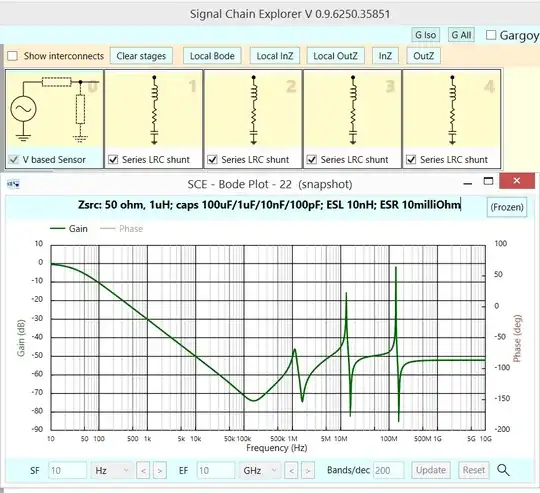

Summary: the individual capacitors need dampening; for 100uF caps, the solder and PCB foil may suffice (10milliOhm, if L = 10nH); for 1uF, use 0.1 ohm; for 10nF, use 1 ohm, etc.
Here with 4 capacitors, 100U/1U/10n/100p and 10nH ESL, the peaking depends on the losses in each cap {I consider sqrt(L/C) a good start; thus 10nH and 10pF needs 3.1 ohms, which I have not used here; however, 10nH and 100uF need 10 milliohm, which is illustrated in the 3rd screenshot.}
Lets examine this response, with 1 microOhm ESR in each cap. Notice the lowest dip is to -120dB. Zsource is only 50 Ohms. enter image description here
Now this response, with 1 milliohm ESR in each cap. Zsource is 50 Ohms.
And now 10 milliohm ESR for each cap, Zsource is 50 Ohms.
And with 10milliOhm in each cap, with the Zsource now 1uH + 50 ohms

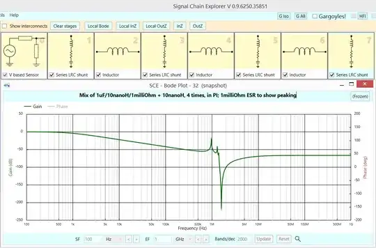

In prior sim, there was no peaking. So I insert 3 inductors between the 4 caps. Now a sim of those 4 caps + 3 inductors (PCB foil, 10nH each). Notice the peaking returns (the ESR is only 1 ONE milliohm, to show peaking), at -20dB.
analogsystemsrf
  • 33,703
    Thank you very much! Your simulations clearly show that, as stated by Ott, we can expect very high anti-resonance peaks at certain frequencies (here 1.05MHz, 10.5MHz, and 105MHz). Could you also simulate what happens when the capacitors are the same value to compare? With say 10mOhm ESR. I have no access to Signal Chain Explorer (sadly). – andresgongora Jul 26 '17 at 07:55
