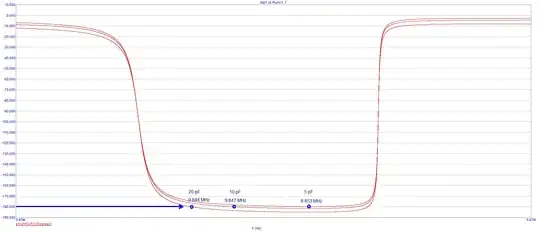

Here's a picture of a sim I did some time ago that shows the bode plot of a 10 MHz crystal and two capacitors. The capacitors on the input and the output of the gate were varied simultaneously as shown. The whole X-axis covered about 100 kHz so it puts it into context how little you can shift a crystal oscillator in reality: -
If I varied the capacitor between 20 pF and 10 pF you can see the frequency range where the transfer function passes through 180 degrees. A little below 10 pF there is a point where the phase shift never reaches 180 degrees and the only way the circuit will oscillate is with the inverting gate running with enough extra phase shift over and above the 180 degrees it is expected to deliver.
The circuit will fail to oscillate if the inverter has to run at a frequency above the anti resonant node in order to produce the required extra phase shift.
Above picture taken from my answer here.
Here's a brand new plot of the phase shift when only the output capacitor is varied (the output capacitor being the one normally associated with the inverter output): -
It will oscillate with 20 pF, 10 pF and just about oscillate with close to 5 pF but any lower and it won't oscillate theoretically.
