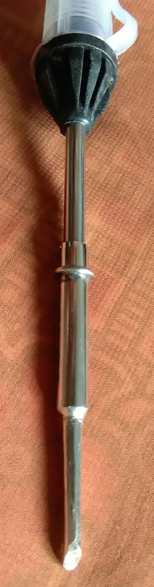

I bought a cheap soldering iron. After reading articles and watching videos, I learnt that cheap irons get their resistor burnt easily. And many a times the iron becomes black as soon as you start heating it and then it cannot be tinned.
I am afraid that if I do not do everything right I will burn my iron too. So I just want to be sure that,
  1. Should I tin my iron first as written everywhere or file it?
I have also got soldering paste and one meter silver coated solder.
  1. Should I first apply the soldering paste on the iron then heat it for tinning?
Update
Soldering iron
Here is the iron. It does not look like pure copper but the cover says its pure copper.
So now that I have shared the final discription of my problem. Please tell me if your opinions about filing it have changed.
Thanks to all of you for helping.

    There are irons which are blocks of copper with forged iron shaft and wooden grip, which can be filed and tinned as suggested. These are usually found in antique shops. – Whit3rd Jul 23 '17 at 06:29
    Generally filing a tip manufactured after around 1960s will destroy the tip. – slebetman Jul 23 '17 at 11:09
    Sure? I have certainly seen non-longlife, non-iron-coated tinned-copper tips on cheap soldering irons in the 90s, and i'd be amazed anything has changed. – rackandboneman Jul 24 '17 at 05:34
    Soldering paste ..... do you mean SMT solder paste (you might be able to use it), rosin/colophonium flux paste (could help!), or flux paste for pipe fitting (don't use it. simply don't.) – rackandboneman Jul 24 '17 at 09:06
    The colour tells you that's not pure copper right away. It may be thin plating (iron) over pure copper - filing will remove the plating, exposing the copper and destroying the bit. –  Jul 24 '17 at 11:33

Never file a soldering tip. Filing it will remove the protective layer, allowing the metal underneath to be eaten away by solder resulting in permanent damage over time. Tin it immediately once it first starts heating up, and every few times you use it as required.

As said by Ignacio ....for most modern hobby tips (certainly for PCB/electronic work) you would never file them. The surface is plated to prevent the copper heat conductor from dissolving in the solder.
Read this for help on the modern plated tip.
That said, there are still plain copper tips produced (typically very large as used in stained glass hobby work) that do need filed. The copper dissolves in the solder as it's used so you end up with work pits in it.

Never file a soldering iron tip. I did an accidental experiment with this a while back; I'd damaged a (Antex CS) tip when it rested against some wood for a while while switched on. Since I had an "emergency" need for it I filed it just to get it "working" again for a few non-critical joints. It did the job to hand, but afterwards was eaten away in a very short time as the solder got to it.
Under normal circumstances there is never a reason to file down a tip. It ruins them.

IF the tip of the soldering iron is either a non-longlife, non-plated type ... or no longer plated due to wear... then filing is indeed necessary. What works best is filing it when heated - this obviously is best not done with an expensive file, it will damage the file eventually - and directly applying solder before a new oxide layer has time to build.
Sometimes, scraping with a thin (disposable/segblade! You will damage a proper edged tool more than you think heating it like that...) knife or screwdriver (thin!, otherwise you conduct too much heat away) immersed in a solder drop gives the most even tinning, since there is no air contact of the bare copper before it wets with tin (this method even works good enough for aluminium to connect a wire to it if you are really patient :) ).
As others have said, this is not the right treatment if the tip is of the plated/longlife type and still intact - once you do it, you will need to frequently do it.
Once you are treating a soldering iron tip as essentially a tinned copper wire, you might want to try hammering the rough tip shape (on hot or cold tip) before reaching for a file: Copper work hardens when hammered, so you get a harder and more durable tip.
Explanation about the "do not use expensive tools": While it is unlikely that a file or knife will wet with electronics grade solder and flux, even less if it is made of stainless steel - chromium alloys are a dog to solder to!, files and knives are heat treated at production time, adjusting hardness, toughness, corrosion resistance. If you heat any of the tool to >>150°C, the heated region of metal will have the metallurgical structure achieved with the heat treatment permanently altered.

Back in the Paleolithic times soldering iron tips were made of copper. You had to file the oxide and pits out of them before you could tin them. In fact, if you go back far enough, soldering irons were big copper hunks that had to be heated with a blowtorch; none of that newfangled electric stuff.
That was then; this is now. Soldering iron tips now have a special coating. If you file that coating off, you will never get solder to wet your tip. So DON'T FILE. Let it get hot, and wipe it on a wet sponge. If there are pits or other defects after wiping, discard the tip and get a new one.
