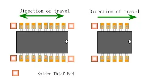

If you design the PCB by yourself you could make a "solder thief pad" also used in wavesoldering. this extrapad will take all the excess tin. enter image description here
