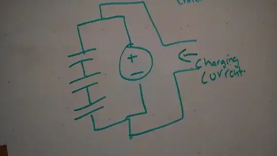

Constant current switching to constant voltage and then shutting off at 4.2, as chargers work, isn’t necessary. All that matters is u don’t put in too many amps st a time and don’t go over or under voltage. Even the amps u can safely put in can greatly vary depending on soc. If it’s getting warm charging back off and will last longer. Ironically blasting w very high current can actually heal cells increasing energy density and destroying dangerous dendrites. But that’s going a step further.
hummina
