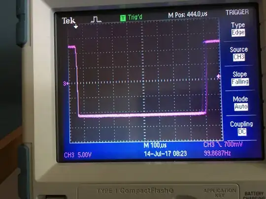

Figure 3
My error was that I was not triggering correctly. This time I selected the trigger mode to channel 3 which is the output square wave and selected the "slope" to be falling.
As you can see that when slope was selected to be falling, the falling edge of the square wave is stable while the rising edge shows some instability.
And when experimented vice versa, the rising edge was stable while the falling edge was not.
