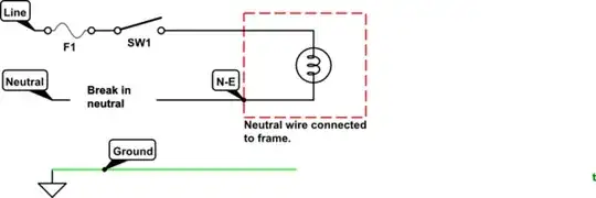

I wrote the linked answer. Here's a variation of the illustrations in that answer.
Figure 1. Device has had neutral wire connected to chassis.
I have added a fault to the wiring. The neutral cable is broken.
Now consider what happens when someone switches the light on. The top of the bulb goes live as does the bottom and the chassis. This is an electrocution risk.
Even when the neutral is OK there is still a problem. With normal currents flowing there will be a voltage drop along the neutral cable meaning that the chassis will be several volts above ground. Touching the chassis and a properly earthed device or steel sink / plumbing will cause a current to flow through the body. Again, this is potentially fatal.

But now do the same thing with the usual case i.e. with the chassis properly connected to the earth. Now in proper case imagine the live touches to the chassis; and imagine also now the earth wire is broken. Now we have the same situation in your first example. What's the difference?
  • Two faults are required to create the danger. In my Figure 1 a dangerous situation could occur with a single fault.
Neutral wire broken we have problem. Earth wire broken we have problem. Why to prefer still earth to neutral?
  1. Because of the voltage drop across the neutral return wire. This is a serious enough concern on its own. The problems caused by this would vary from not noticeable through ticklish to fatal.
  2. We wish to maintain the chassis at earth potential so we use a dedicated wire which does not carry any current except in the case of a fault.
  3. Your RCD/GFCI would not be able to detect a fault in your scenario. These devices offer additional protection in these cases.
  4. Separation of power and protection circuits.
