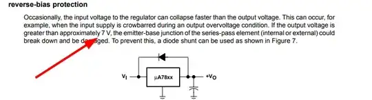

It seems rather unlikely to me that this is the cause. The output voltage has to be greater than the reverse breakdown of the B-E junctions in the regulator to cause damage, and 5V is not. There also has to be significant current flowing back (both conditions are necessary for damage to occur).
For example, the TI datasheet specifically says:
I suggest proceeding with caution and looking for something else that may have caused what appears to be significant damage. For example, reversed power connections.

    Is it possible the Fairchild LM7805 has a different realisation as the linked data sheet mentions no such shunt diode nor any break down voltages? Also they mention short circuit protection. – Emily L. Jul 09 '17 at 23:33
    @EmilyL. Unlikely. They're all pretty similar.. all have short-circuit protection and shut down with very high junction temperature. But those protections can't save the chip if it's abused by putting 10V on the output with input grounded (or 50V on the input). – Spehro Pefhany Jul 09 '17 at 23:37
