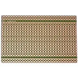

Is there any usable program that could help me organize elements on PCB breadboards? Or maybe some kind of autorouter?
By PCB breadboard I mean something like this:

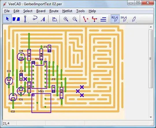

Have you tried VeeCad?
The screenshots/examples on the web page make it look as if it is limited to board with horizontal strips. But according to the feature matrix, it does "[c]ustom track patterns, including SMD components."
Googling around, I found this screenshot of a custom board layout being used in VeeCad (see below).
Another possibility is DIY Layout Creator. This is multi-platform freeware program (GPLv3 license).
Image of Veecad output in simulation case.

    This is not my circuit; I found this screenshot of a VeeCad window in a search for evidence that custom boards can be represented in the program, not only the simple strip boards shown in the screenshots on the home page. VeeCad is a program for laying components on a pre-manufactured PCB, not for routing custom copper between components. The traces are isolated because they are part of a predefined template. They are sitting there waiting for components to be hooked up, which might never happen. – Kaz May 10 '12 at 15:24
