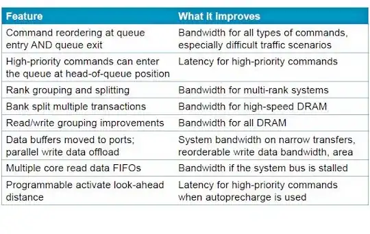

I forgot to mention DDR4 will actively queue memory fetches on a priority basis to improve performance. So SDRAM's are much more than just POD memory chips.
