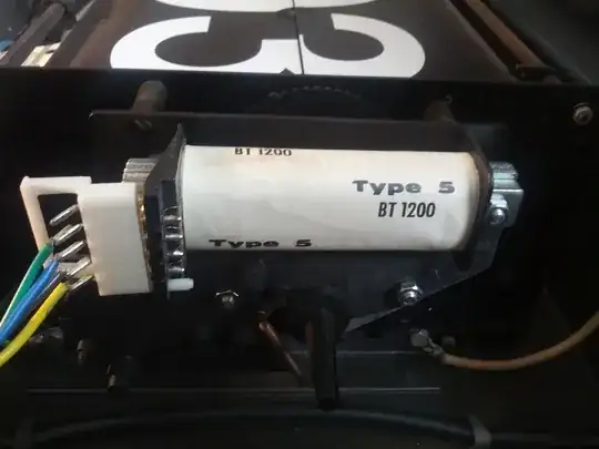

I can't get the motor to run. I (carefully!) connected the motor to the mains (220V 50Hz). The results was a chaotic buzzing and the motor oscillating. The motor look like this:
The assembled synchronous motor
I have no idea what 'Type 5' or 'BT 1200' signifies (I googled it extensively). The coil has 4 wires running from it. Counting from top to bottom, or from green to yellow, the resistance between:
  • 1 and 4 (green and yellow) is 460 Ohm
  • 2 and 3 are shorted (0 Ohm), not in the coil but the blue and black wire
  • 1 and 3, 2 and 4 is 230 Ohm

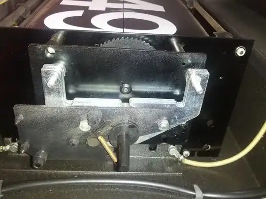

With the coil removed the axis becomes visible:
Coil removed

I can easily remove the axle as well:
Axle removed
Behind it is the gearbox. The motor is obviously not a Shaded-pole motor.
So how does it start? Perhaps it needs a different voltage (the clock was recovered from an industrial complex)? 120V, 480V? Is there a (start) component removed? On the second image there are some protrusions visible on the left side of the axis with no obvious function.

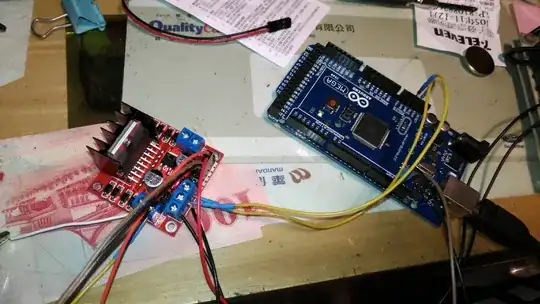

I got the same flip clock that I found from internet which has the same motor. I didn't find answers on how it works -- just that it needs a master clock. After this discussion I got a idea and tried applying 12 VDC to the motor with (Y&B) (R&W) wires as pairs.
BT600 type5
And I found that when it changes pole between red & blue draw line it will flip. So I used a 1 second pulse with a 1-minute period using an Arduino and a motor driver board L298N. Here's the program:
const int motor1a = 12;
const int motor1a = 13;
void setup()
pinMode(motor1a,OUTPUT);
pinMode(motor2a,OUTPUT);
void loop()
digitalWrite(motor1a,LOW);
digitalWrite(motor2a,LOW);
delay(59000);
digitalWrite(motor1a,HIGH);
delay(1000);
delay(59000);
digitalWrite(motor2a,HIGH);
delay(1000);
setup
Finally it happily worked.
