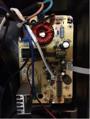

I have an Ac to Dc switched-mode power supply that looks a bit like this : enter image description here
Now as you may or may not know, there's the Ac input with a N and a L for neutral and live line. Now I want to know if it's ok to plug the Live line on the neutral side and vis versa. Also how am I capable of knowing wich of the wire I connect to it is the Live or Neutral line. Now I've also been told not to do this, thanks for explaining me why is that..
One good reason to do this is that the internal fuse will be on the L terminal. This is somewhat safer because if the fuse blows the power-supply is internally isolated from the mains live. If the fuse blows when wired the other way around then the internal circuitry is still live and the neutral is disconnected.
