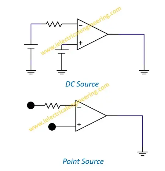

Two to four diodes and a capacitor will get you a long ways, without the complications of battery charging (which is picky to do well, depending on the type/chemistry, some being more difficult than others.) The concept you are after at that level is not too complicated - a rectifier (converts AC to DC) and a filter (smooths out the pulsing DC.) You'll want those anyway for a system with a battery, but with a small LED current and a fairly large capacitor, you may find that your application can be adequately covered with just the capacitor.

  • Thanks so much for these answers! Yes, I also bought a bridge rectifier/diode bridge, so this schematic really helps, thank you. I also considered placing the magnets closer to the rim for the same reason of higher rotational velocity, but they would be further away from the coil since the wheel tapers away from the fork as you get closer to the rim. Could solve that with some sort of arm extension for the coil, though. – Victor Vulovic Jul 05 '17 at 20:05
