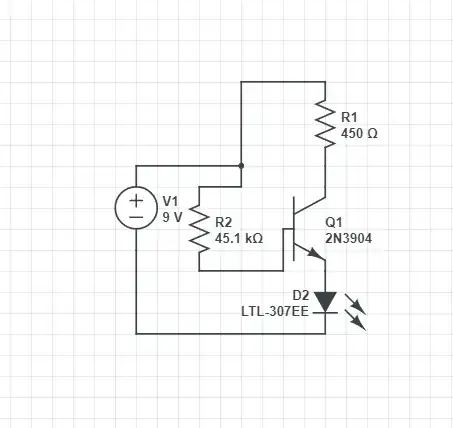

  • @sstobbe Ok, let's say there is a 9v power source, with a 450 ohm resistor preventing the current from going above 20 mA. The Ic I calculate ends up around 110 mA. As far as I know 110 mA wouldn't be possible since the resistor is limiting the current, so what does the 110 mA mean? – Evan K Jul 04 '17 at 02:41
  • @EvanK That is a much better question to ask, if you edit your question to be: "Why does a BJT enter saturation?" with a sample schematic as you described you will get a concise answer – sstobbe Jul 04 '17 at 02:47

I have simplified your schematic slightly to illustrate the concept of saturation.
Take for example the following schematic, enter image description here
Here the current into the base terminal is set by an ideal current source (only for convince in a Spice simulator) in a real circuit a resistor is often close enough to set the base current by ohms law.

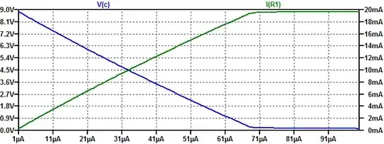

The following figure is the simulations reults of a DC sweep of the current source injecting into the base terminal. The x-axis is base-current. The left y-axis is the collector voltage. The right y-axis is the collector-current. enter image description here
We can see that when the collector-emitter voltage is greater than ~0.2V the forward-active relation holds true, namely, \$I_C = \beta I_B\$. As more base-current is applied more collector-current flows. However as more current flows more voltage is being dropped across R1 and the collector-emitter voltage is dropping. Eventually when the collector-emitter voltage becomes small enough the BJT is no longer in forward-active but in forward-saturation.
The textbook definition of forward-saturation for an NPN BJT is when Vbe is positive and when Vbc is also positive.
In saturation the BJT, loosely speaking it looks like a switch between collector and emitter. Slightly more complete model is a small mV level voltage source with low series resistance.
So when the NPN is behaving as a switch (saturated) it is the circuit around it that dictates what current will flow, in your case R1.

  • Ah, I see where the confusion is hitting. Let me back up. In the site, they say to calculate for Ic, as this is the current that will be passed through the transistor. Then, it was said that it would be 100 mA. I'm confused now what it means when it isn't possible for 100 mA to be flowing, as a resistor is limiting it down to 20 mA. Am I getting confused about the purpose of forward-active mode? I thought it was for current amplification. – Evan K Jul 04 '17 at 03:51
  • I guess I am asking how to solve for what current is actually flowing. In the circuit diagram provided, what is the current through the LED? Is it evaluated by a simple ohm's law equation, or is the equation more complicated? When I made a circuit representing it, changing R2, even though the Ic was well above the amperage supported by R1 every time, the LED's brightness changed. – Evan K Jul 04 '17 at 03:54
    You do it like a diode---first guess what operating mode it's in and solve under that assumption. Then check whether the pre-requisites for that mode are held (\$V_{ce}>0.2 V\$, for forward active). If not, guess again about the operating mode, solve, check. And so on (if you have multiple BJTs in the circuit you have to consider different combinations of modes for the different BJTs). – The Photon Jul 04 '17 at 04:15
  • @EvanK please notice that a transitor with its load in the emitter cannot saturate. If you want to play with a transistor in saturation put the load (LED) in the collector. – Claudio Avi Chami Jul 04 '17 at 04:15
