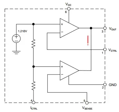

My major hangup is this block diagram:
I'm not interested in actually using this device as much as I'm interested on why it can work when it's tying the outputs of those two op amps together, wouldn't that just make this device a magic smoke generator? (Obviously not, but right now I don't know why)

The data sheet states that the outputs that can only sink current. This is very common for comparators to have open-drain(or collector) outputs.
Since they only sink current they do not have normal opamp push-pull outputs and it is acceptable to tie them together.
It also means that there must be an external current source feeding the output - normally this would be a resistor pull-up to the positive rail of the power supply.

The datasheet doesn't explain it but a look at the load gives us a clue.
Figure 1. From AP4306 datasheet page 2.
  • Note that the load is the opto-LED which is powered from Vout+. The amplifiers (1) and (2) never have to source current. This means that open collector outputs can be used on the opamps. Open collectors can be paralleled to form an OR gate. In this case if either output 1 or 2 turns on the LED will turn on.
  • If amplifier 1 inverting input ever goes above 1.210 V its output will pull low turning on the LED and (presumeably) switch off the SMPS switcher as the voltage is now >= setpoint.
  • If the current exceeds the current limit threshold the voltage at the inverting input will exceed that on the non-inverting input and it will turn on the LED limiting the power delivered.
I can't see any DC feedback on the circuit so the opamps seem to be used more like comparitors.
