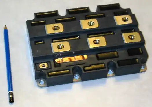

You mentioned that you were on Digikey; I'm guessing that you took a wrong turn and went looking for a high-current part in the 'Discrete Semiconductor Products' group, section IGBTS - single. This section is for PCB-mounted components. The realities of PCB manufacturing (soldering, copper thickness, heatsinking) will limit the practically achievable values here. If you want to get really high-current stuff, go to 'Semiconductor Modules', that's where the chassis-mounted parts connected to thick wires are located. The IGBTs section there has components like this beast, shown with a pencil for scale (borrowed from Wikipedia):
That device can actually handle 3300 and 1200 A; it's 190 by 140mm rather than a little PCB-mount device. There are plenty of smaller, more reasonable devices available as well.

    Coincidently, I know a guy who designs the electronic systems for electric locomotives, who used exactly the shown IGBT (CM1200HC) to drive a 2MW electric motor on an HST loco. They had to get a custom-made heatsink to dissipate the heat. The test setup was amusing - a tiny pushbutton to switch the motor to 100% power, causing the entire loco chassis to tilt as the motor span up. It made a noise like a dragon undergoing a root canal. – Polynomial May 08 '12 at 00:45
