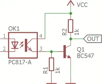

If you really want to use the 4N35, then it is possible to speed it up by adding a transistor as an amplifer with a lower input impedance:
PC817 MIDI
But the simplest method to get the MIDI input to work would be to use a high-speed optocoupler like the H11L1 or 6N137.
