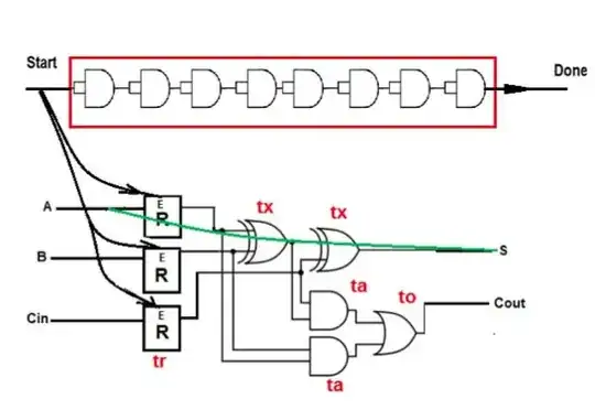

Is it possible to send a READY signal when the output of a module is stable, without specifically timing the propagation delay of the module circuit?
No.
If not, what would be the simplest way of delaying a READY signal based on a circuit's worst case propagation delay?
For each module, you have a matched delay line made up of a series of AND gates setup as buffers.
See images below:
