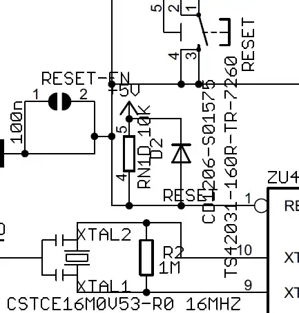

And don't clutter your schematic with unnecessary information.
This is part of an A4 size schematic which I had to blow up to over A2 size to be able to read it. (That schematic fails the olin test with honors.) Only show refdes and value on your schematic. The resonator bottom left for instance doesn't even show a refdes(!), but it does show pin designators and the product's ordering code. Don't! Just display "X1" and "16MHz". The pin designators "XTAL1" and "XTAL2" are useless, and the ordering code belongs in the BOM, just like things like package and such. Don't say on your schematic that a resistor is an 0603; you don't have to know that to read the schematic. Is useful for the assembly shop, but they'll only get the board layout and the BOM, not the schematic.
If the "CD1206-S01575" and "TS42031-160R-TR-7260" weren't there I might have been able to read it at A4 size.
