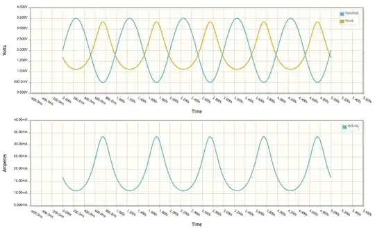

Use Behavioral Sources and Expressions to define a behavioral voltage source where the voltage is proportional to the current, but the "constant of proportionality" varies with other voltages.
Ohm's Law goes from the simple form:
$$V_x = I_x \cdot R_x$$
to a form where we let the resistance be a function of other voltages or currents in the circuit:
$$V_x = I_x \cdot f(v_a,v_b,i_j,i_k,\dots)$$
Here's a quick example:
Open the circuit in CircuitLab to simulate. In this example we've defined V3 to be a behavioral voltage source with the expression:
$$V_{\text{V3}} = I_{\text{V3}} \cdot 100 \ V(\text{control})$$
Since the element-wise voltage is proportional to the same element's current, it looks like a resistor, with effective resistance:
$$R_{\text{eff}} = 100 \ V(\text{control})$$
If you run this simulation, you'll get the expected current and voltage plots for the time-varying resistive voltage divider: behavioral sources simulate varying resistance in CircuitLab
