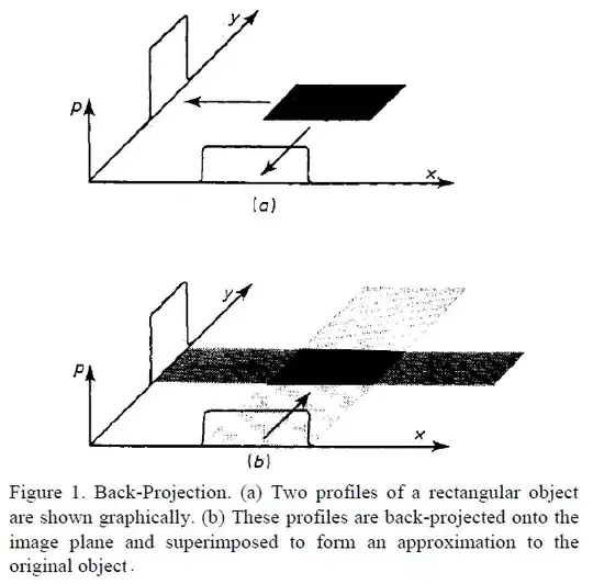

Back Projection in x-ray tomography and MIT, shown in figure 1, is a basic method of imaging cross-sections through an object.
For x-rays, back projection uses the summation of x-ray attenuation coefficients and for MIT we will use the summation of voltage phases between driver and sensor coils, but the method is essentially the same. In the most simple case, back projection, as shown in figure 1(a and b) involves the object being imaged in 1D by a row of sensor coils at 0° and also 90°, thereby obtaining a projection as shown on the x-axis at 0° and one on the y-axis at 90°. Using an algorithm the 2 projections are smeared across x-y axis as shown in figure 1(b). This is achieved by summing the phase values of the x and y axis projections so that the intersection of the 2 projections is highlighted. Interpolation of x-y values is also used to increase the number points in the cross-sectional mapping procedure to 32 × 32. The main part of the code for this is shown in figure 3, and the equation of simple back projection is given in (1) and (2)1.
\begin{equation} \hat{f} = \sum_{j=1}^{m} p(x cos\phi_j + y sin \phi_j, \phi_j)\Delta \phi \quad \textrm{(1)} \end{equation}
\begin{equation} p_\theta (r) = \int f(x,y) ds \quad \textrm{where} \quad r = x cos \phi + y sin \phi \quad \textrm{(2)} \end{equation}
Also see figure 2. In the following ‘ray’ can be interchanged with straight lines of ‘magnetic flux’. $$\hat{f}(x,y)$$ is the approximation to density-function produced by Back projection; $$p(r,\phi)$$ is the ray-sum or ray-projection, or 1D projection of phase shown in figure 1(a);
‒ distance of a given ray from the origin (figure 2); ‒ path length along a ray; (,) ‒ density-function of object (linear attenuation coefficient in the case of x-ray tomography, and phase angle in MIT); ‒ angle between a given ray or group of rays and the y-axis; m ‒ number of projections.
