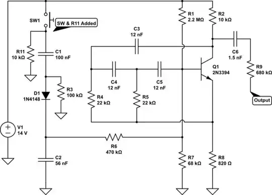

I have a phase shift oscillator circuit from a drum machine that I would like to reproduce as faithfully to the original as possible. My problem is that the 40 year old design uses a transistor (2N3394) that is no longer available. But... the others from the same data sheet (2N3391, 92 & 93) still are. The only difference between them is that the hFE is higher than the original.
Here is the circuit (as it is presented in the original schematic):
Note: I added S1 and the pulldown resistor (R11) to replace the original trigger. The output was originally fed to a summing bus, and then amplified.
The Intention: At this point, the plan is to faithfully reproduce the circuit on a breadboard (or PCB) and experiment with modification options and values without damaging the original device. I am considering a) only modifying the original drum machine; b) re-creating the drum machine with the modifications; or c) re-creating a few of the individual sounds as single units, and providing amplification for each one, rather than summing to a mono output.
So the main question is: Would replacing Q1 with a higher hFE transistor have any bearing on either the decay time, amplitude or frequency of the output?
Secondary to that is: When seeking out a replacement, what specifications, if any, have a bearing on those same parameters?
Additional Note: While composing this question, I reproduced this circuit using the Falstad Simulator, and found that even changing the hFE within the range of the original part (hFE=55-110) presented major differences in the output. But… from what I understand, the hFE can vary greatly within the given range, and is unreliable. This causes me to question the results I am seeing. If this were not the case, I would have taken the simulation result for my answer.
Here is a snapshot of the output at the C6/R9 junction:
Phase Shift Oscillator Output hFE=55-110
Left: output at hFE=55. Right: output at hFE=110
The waveform result at hFE=55 seems to best represent what I hear in so far as the "sharp impact" which fades out, and also looks like the waveform image presented in the original schematic - down to the phase and number of peaks.
Schematic Source: Here is a link to the service manual that I referenced this design from. It's difficult to read due to the low quality of the scan, but the values in my own schematic were taken from a hard copy.
Null

  • You say that it was "originally fed to a summing bus." Are you still planning on doing that? Or are you planning something different for the output, now. Are you still planning on the same 14 V rail? Or is that to be changed? Etc. Can you discuss your plans in more detail (and not just the prior circuit and its simulation details?) I'm curious. – jonk Jun 26 '17 at 19:30
  • By the way, this page may help you a lot on understanding (and answering your own question) the issue about the oscillation frequency for your setup: http://www.electronics-tutorials.ws/oscillator/rc_oscillator.html (Note that this is where \$\beta\$ may affect things as it affects the base loading on the last stage.) You can do the computation on that web site assuming the loading works out to a final resistor value that is also the same and you will get an oscillation rate that is close to your graph. – jonk Jun 26 '17 at 19:58
  • beta is pretty important for this circuit Q1 gets biased via C2 & R6, so the discharge time of c2 will vary with beta – sstobbe Jun 26 '17 at 21:22
  • You can easily adjust the duration of the oscillation by changing the value of \$C_2\$. Larger values will lengthen the duration by holding the base of \$Q_1\$ up longer. \$C_2\$ is jacked up by the switch and raises the base of \$Q_1\$ from "just barely *off*" to "just barely *on*" so that it can provide higher current gain (low gain at low collector currents) for the oscillation. Subtle design element. I'm growing to like it more and more. (Just dawned on me. But I'm a slow-minded hobbyist and that schematic layout could be improved to make this fact more obvious.) – jonk Jun 27 '17 at 06:44
  • Also, the connection of \$R_4\$ and \$R_5\$ to a low-impedance, nearly in-phase copy of the base signal significantly aids the oscillation when started and does so without adding components. Nice. – jonk Jun 27 '17 at 07:05
  • @jonk See update to clarify your first comment. I've read similar pages, as well as your link (2x), and just can't extrapolate the effect that *ß* has on the envelope - or how it is controlled to remain in the lower end of the range. Probably because I am more familiar with Vgain, and avoiding Igain due to it's claimed "schizophrenic" nature in transistors. I've seen no tutorials using the same arrangement - which would likely clarify the point I am missing. I'm *guessing* the uncommon fact that R4 & R5 are fed back to the emitter has something to do with it? More... – Jay Jun 27 '17 at 13:51
  • @jonk *continued* I have located some of the modifications that can be made thanks to the rather clear theory of operation provided by the technical manual this was taken from - and also played with the values of C2 to extend the duration. Funny you mention it, as that it was one of my intentions. The circuit fascinates me, and the sound of *all* of the voices is what drew me to learn more and reproduce and modify it. None the less, I am stuck on how the range of *ß* within the used transistor is "reigned in" to produce the correct shape. Have to learn more on that I guess. – Jay Jun 27 '17 at 14:07
  • @Jay Thanks. I'd love to see the technical manual, if that's possible. As more specific details have become clearer, I'm finding that I really enjoy the circuit still more. It's nice and I'm glad you presented it. It has basic elements I recognized right away, like the 3-stage RC phase-shifter. But it has some subtler elements it took me a moment to get -- \$C_2\$ and the \$R_4\$/\$R_5\$ connection to the emitter. Both are important details, though. \$\beta\$ changes the loading on stage 3 and slightly adjusts the frequency, adds energy so longer burst, and adds amplitude too. – jonk Jun 27 '17 at 15:18
  • @jonk Sure. I'll add a link to the original question in a moment. It's not the cleanest copy. There are 8 of these oscillators on board, with variations for the instrument they are intended to represent. I chose the Bongo as the simplest iteration for this discussion (with components numbered as circuit lab provided). As the manual says, C2 works with R6&7 (by my numbering) to generate the time constant for the envelope - another reason I questioned if, and then how *ß* was a factor. – Jay Jun 27 '17 at 16:39
  • A design technique that was more common in the past was hand-selection of components. That is, you would design a circuit with a specific criteria in mind, and then you would bin components that satisfied that criteria. I would not be surprised if this circuit is an example of that. – Edgar Brown Nov 13 '18 at 07:09
The classic 3 section phase shift oscillator requires a voltage gain of 29 to oscillate continually. Of course you do not want continual oscillations since you need a damped sine wave out.
The Hfe of the transistor does not directly affect the voltage gain but will affect the input impedance which will affect the loss in the phase shift network and thus the Q of the resultant circuit.
Your circuit is slightly unusual in that the emitter resistor is not bypassed which should introduce negative feedback (emitter degeneration) and stabilize the circuit with respect to Hfe variations.
I'm surprised that R4 and R5 return to the emitter and not to ground - it's not immediately obvious to me what effect that has.

  • I agree to the unusual nature of the circuit - but only because I cannot find any similar arrangements as of yet. Being that *ß* does seem to be the issue at the moment, are there any further parameters I should try harder to match when choosing a replacement? – Jay Jun 27 '17 at 14:45
