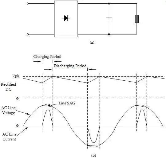

To measure current, use a CT (current transformer) - this converts the current taken by a load or appliance into an isolated and manageable signal voltage that is proportional to load current but, beware, if your currents are not sinusoidal, then trying to compare the zero crossing point of voltage and current is going to be a big problem. Consider an appliance such as a TV or HiFi and look at the typical current taken: -
With these sorts of appliances (and many others too), the current drawn from the AC line comes in very non-sinusoidal blips coincident with the recharging of a reservoir capacitor after the bridge rectifier.
If you were to take a zero-cross point of the current waveform, where would that be in the picture above? In other words, for many household and some industrial loads, you can't use zero-cross detectors to give any indication of the relative phase angle between voltage and current.
Simultaneously sample v and i at a fast rate such as 1 kHz minimum, then multiply and average to get power taken. Also compute Vrms and Irms and compute power factor of load using: -
PF = \$\dfrac{Power}{V_{RMS}\times I_{RMS}}\$
