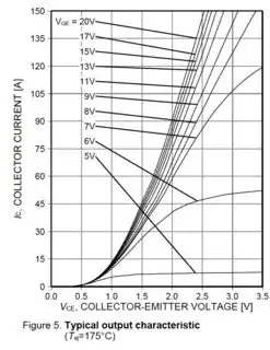

The data sheet gives the voltage drop at specific currents and has a curve in figure 5 on page 8 that could be used to determine the voltage drop at various currents. Notice that it does not intersect at zero as a MOSFET would and requires about 0.5v to start conducting. enter image description here

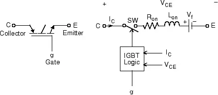

The Simulink model treats the IGBT DC output characteristic as having two segments:
  1. Vf - The voltage at which conduction starts
  2. Ron - The slope of the conduction after that point
Simulink IGBT model
From the curve the Vf is 0.5V.
To calculate Ron draw a straight line through the curve from 0.5v to 2.5v. The current increases by ~140Amps over this 2V range. This is equivalent to a resistance of 2/140 = ~14mOhm (0.014 Ohms).

    I looked at the IGBT model description and they have both a turn-on voltage (it would be about 0.5V for the device you selected) plus the Ron that would be the slope of the curve after it is turned on - this is not the same as what you calculated. If we draw a straight line from 0.5v to 2.5v the current increases by ~140Amps. This is equivalent to about 7 mOhm. – Kevin White Jun 21 '17 at 16:39
