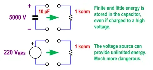

I like being graphical.
Your hair, when charged electrostatically, acts like small capacitors charged to high voltages. The energy stored in those little capacitors is finite and small, and so it can do little harm to you.
On the other hand, a 220 Vrms outlet has a much lower voltage, but it is an unlimited source of energy. Even acting upon the same load resistance, this is much more dangerous, because all that extra energy means it can cause more heating of your tissues, and therefore more damage.

    We have a 10pF at 15kV, I am not brave enough to touch it. Our bodies are on the order of pF to my knowledge, charging to more then 10kV is very very rare. Your 5kV number is very reasonable, good answer. – Kortuk May 05 '12 at 00:24
    @Kortuk Thank you. The Human Body Model (HBM) http://en.wikipedia.org/wiki/Human_body_model specifies 100 pF and 1500 ohm. That's kind of a worst case. – Telaclavo May 05 '12 at 10:07
  • Excellent description with graphics. This should have been the accepted answer. – hkBattousai May 10 '12 at 18:06
